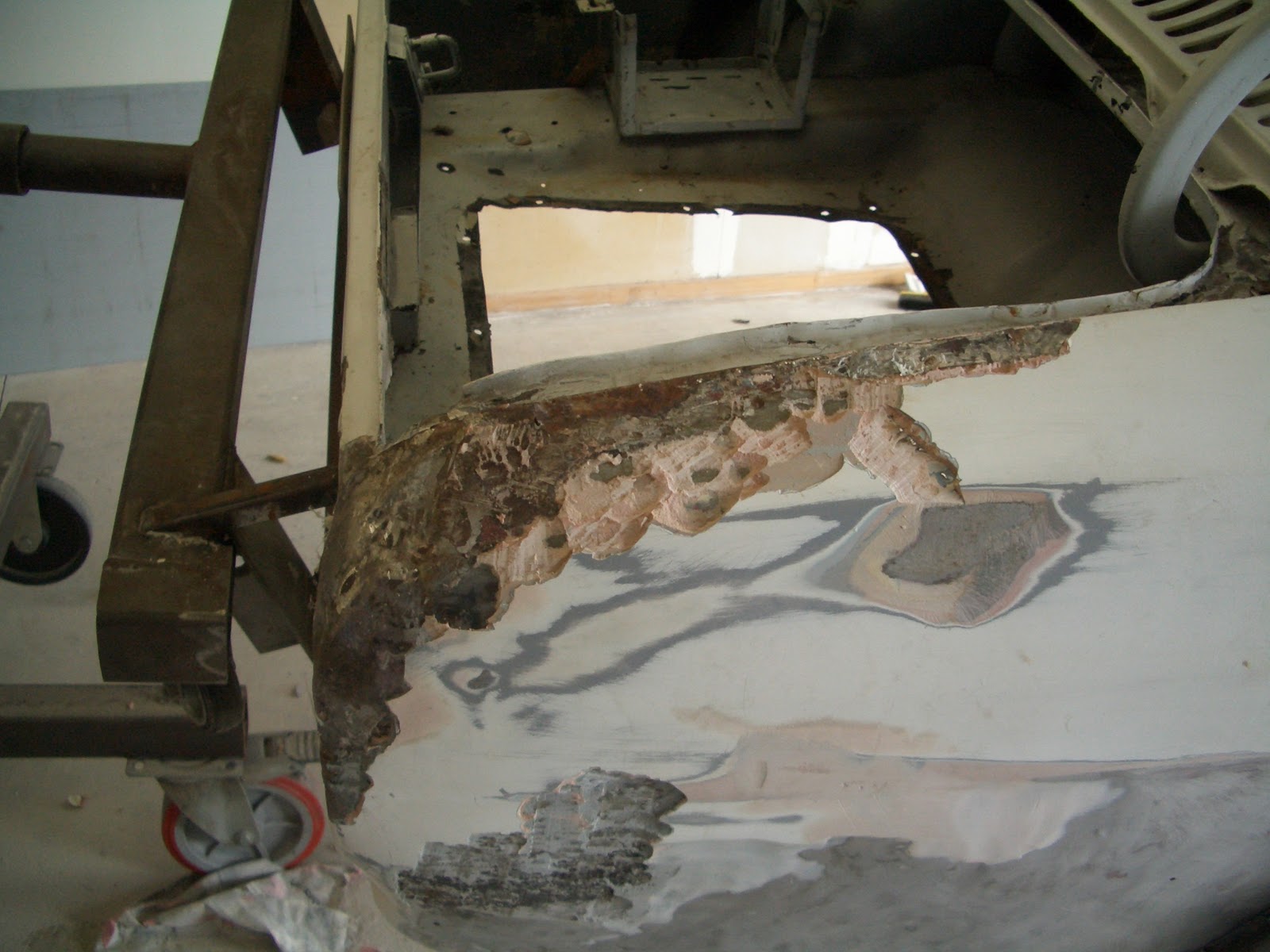

Bog !
marcos1, Oct 27, 5:32pm
The bog is not a problem. The rust will be tho.
Is that you GD!
vat69, Oct 27, 5:32pm
lazy bastards.good luck mate kick them in the bog spreaders
drew2009, Oct 27, 5:34pm
I can never understand why people bog up doors and boot lids ect. so much easier to just bolt on a new panel. Whats the owner got planned for it!
nathanmac, Oct 27, 5:35pm
I thought I had the record for the most amount of bog applied to a car - my first Corolla. looks like I have a ways to go.
franc123, Oct 27, 5:44pm
Its what you have to expect when restoring cars that old, you are not just erasing 45 years of general deterioration but also having to erase 45 years of substandard repairs as well, something that I'm being well and truly reminded of myself restoring a 60's vehicle at the moment.Besides HD/HR Holdens were notorious for rusty doors, any panelbeater who was working in the 60's/70's will tell you that many of them had perforated doors within 5-8 years.The story goes that HD sales were so strong in early 1965,even better than the EH,that GMH overproduced the panels for them and many ended up in storage for some time and exposed to moisture, and surface corrosion wasn't removed properly before the cars were assembled some time later, it took a while for them to be used up as sales fell off badly later in the model run when the model had to be quickly replaced by the HR. That damage looks like they might have been kicked in being so far up on the door though.

Its an HR Holden ,half of the bog is probably factory, the other half was probably put in in the early eighties so it hasn't done too bad mate. that was the era of backyard panel and paint or "bog and flog", everyone was doing it. Not many HR's around now though so be sympathetic and check out the bones before you reject it totally.
grangies, Oct 27, 5:56pm
Yep. It's definitely crash damage that has be very roughly repaired.
The rest of the vehicle ( while rusted in certain areas ) is thin paint on top of fairly clean sheet-metal.

looks like a factory holden paint job. whats the issue! hope your not destroying a good bog job with a shooddy proper steal job!

Looks like a lot of that will hammer out, whoever did the last repair must have had a weak left arm.
grangies, Oct 27, 6:48pm
Or no left arm at all. LOL.
The left front guard is quite funny. I've taken a lot more paint and bog out since the photo, and came across one heat shrink mark. Only ONE lol.
It's like they decided to to give it go at doing a reasonable job, then gave up.
The owner seems to be not short of $$ so I'm going to talk him in to getting the front guards soda blasted inside and out, then go from there.

The owner has agreed to a new skin for the left rear door.
