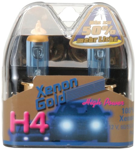

intrade, Sep 29, 9:56am
http://ecx.images-amazon.com/images/I/51UMD8agZtL.jpg
thats the bulbs i got for about 20$nz dont know how good they are they are 50% more suposedly brightness. not 80% as i had in my head from above post.
