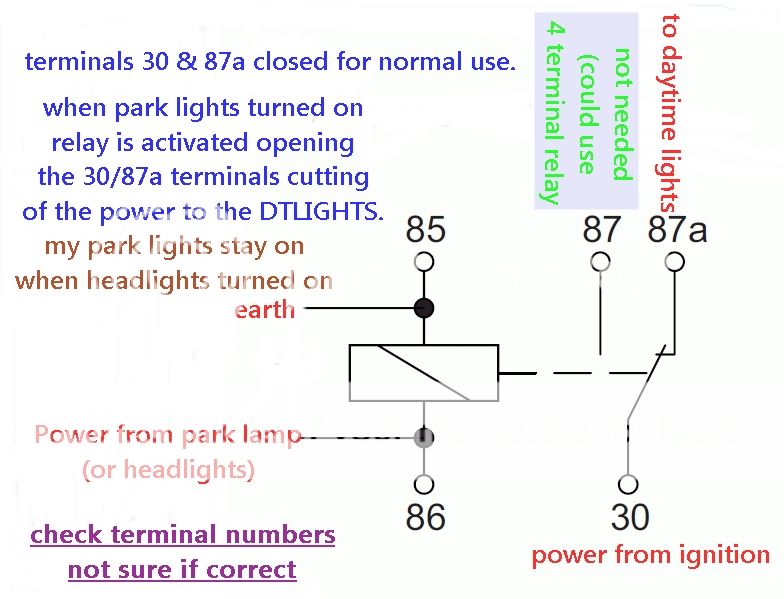

Can be easily done without diodes using a relay. Use power from headlight to operate the relay so as to cut power off going to the daytime lights.

I fitted daytime lights to my Maxima and just used a relay without diodes to turn off the daytime lights when headlights were turned on. Power from an ignition sourcevia relay to the daytime lights.wire from headlights power source to relay switch and earthed the other side of the relay. When power is fed to headlightsit closes the relay and cuts off the power from the ignition to the daytime lights.

Got a diagram of how to hook up the relay. Just having trouble getting mental image but once I see a diagram it becomes clear to me. Cheers.

have diagram saved as a JPEG file on the computer but don't know how to upload to message board
