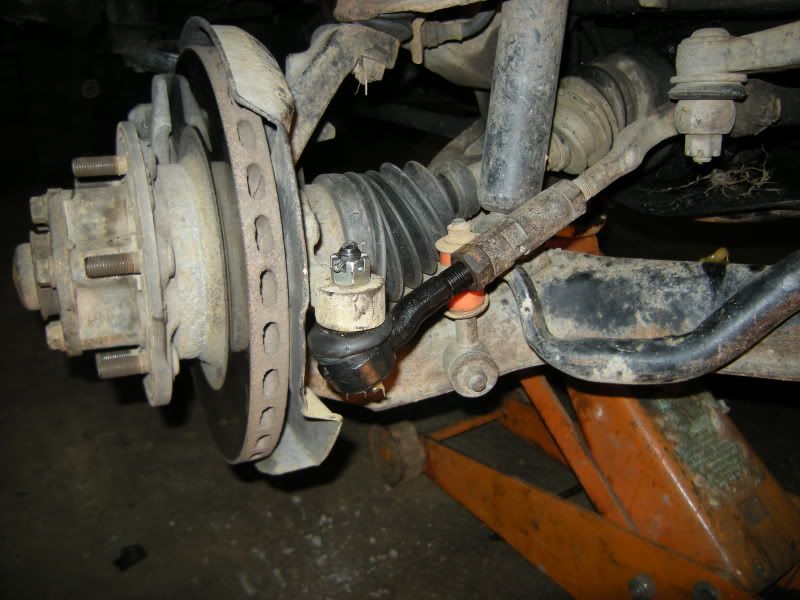

Sorry if I didn't explain very well. Its a 1994 4m40 Pajero. Broke the Tie Rod End about half way between the adjuster and the ball joint. Outer jam nut still in place against the adjuster and the inner jam nut free and wound up the thread of the inner.
caleb.b, Aug 23, 7:16am
Don't have pictures of the damage. Here is a picture of an adjuster on a similar Pajero.
http://i29.photobucket.com/albums/c252/showjumper90210/DSCN1376.jpg
snoopy221, Aug 23, 7:18am
Okay could have been a damn valiant from your description.
So you are saying that only ONE lock nut was undone when TWO need to be undone and some iriot got heavy handed and broke thangs proving exactly that.
PIC
Edits had pic of left hand side your pic again shows as i have stated
caleb.b, Aug 23, 7:25am
Sorry, Yes I see the confusion now. Next time ill put pictures up and state vehicle in original post. He claimed he was undoing the second lock nut but all the teeth marks in the nut and adjuster showed he had his pipe wrench across the two at the same time. He then tried to tell me how there wasn't much room in there and may have got it across the two on an angle and then proceeded to show me him fitting his pipe wrench tucked up in there. Still didn't grasp the concept that the pipe wrench might not have been the best tool for the job.
snoopy221, Aug 23, 7:35am
Mate pipe wrenches and pipe and a damn gas torch are actually useable especially on old valiants that have a pipe adjusting section with clamps at each end and being clamped instead of a lock nut they have a split in the outer pipe tube section which when iriots align and leave upwards and water and crud gets in their and siezes them-LOL
But in your case the iriot has no clues and has not undone the 2 lock nuts properly as a given is BOTH are opposing threads.
Go see the iriots boss
And never EVER expect such an iriot to understand camber castor toe in ackerman and K P I
Go see James here and get a referral to a DECENT wheel alignment place
http://supremeauto.nz/

Somebody can't visually identify a left hand thread I'd say. He has tried to undo the second locknut the wrong way. Good luck.
supernova2, Aug 23, 8:32am
I agree, in fact i don't think he even thought about it and was used to a standard end on a rack which just swivels the rod without having to undo two lock nuts. Absolute clown IMHO.
