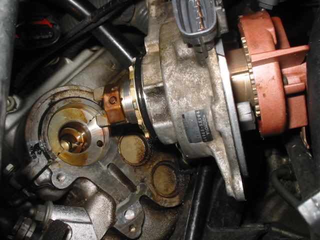

johnf_456, Jun 29, 3:22pm
It is most likely the o ring on the distributor shaft seal, a cheap fix and very easy to get. When cars get older it is more common for them to leak through the dizzy. But then again I don't help apparently.
Edit: http://i99.photobucket.com/albums/l308/joandjo77/IMG_3167.jpg
They look like that
lugee, Jun 29, 3:29pm
My mistake its actually weeping from below the cylinder sensor. A small amount of weepage around here is relatively normal (as I said its not enough to cause a drip). I imagine it may slowly get worse and it looks like its an o ring on the shaft, similar to the dizzy so I'll look into it in the future, I'll also give the valve cover a little tweak to see if that helps. Thanks for the tips
