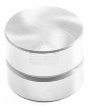

quater, Apr 29, 8:25pm
skin1235, Apr 29, 8:33pm
HLA = hydraulic lifter assembly
where does the shim go
this is a single cam!, valves are below the cam shaft! not offset and have rockers that operate the HLA
quater, Apr 29, 8:37pm
Its a dohc and the HLA sits under the cam and the piston in the HLA sits on the valve head. they are called so many things it does my head in.
