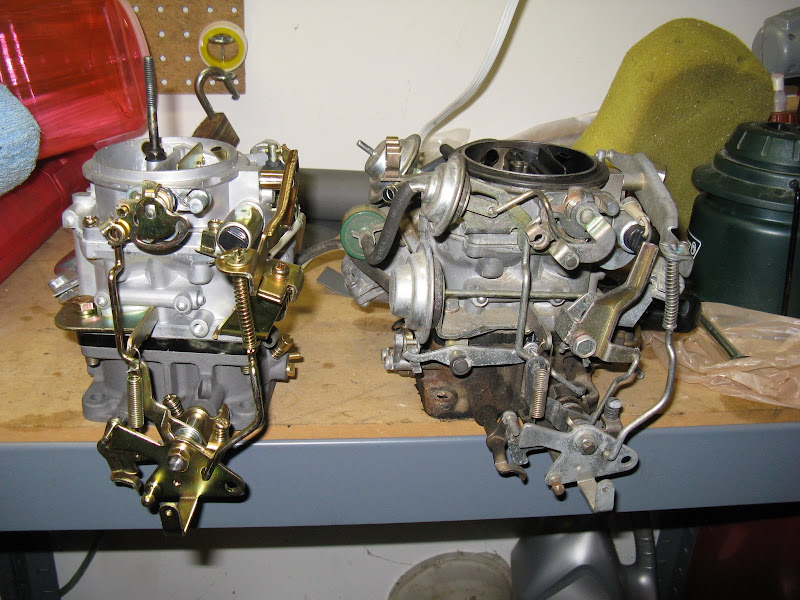

snoopy221, Jan 6, 5:46am
https://forum.ih8mud.com/proxy.php?image=http%3A%2F%2Flh3.ggpht.com%2F_akjNS0GpWdc%2FSpSUU9Cn49I%2FAAAAAAAADBo%2F43qYxlz0V-M%2Fs800%2FIMG_3766.JPG&hash=486c26db09f37b0d9497c9782e2f94ab
Zee round plastic doofery in zee piccy on da right is zee sucker zat ya suck through it oneee way and suck through it zee other way.
And ONE WAY ONLY
Is an EASY suck.
Green one end one rubber vacuum hose either side
Marked A and B on either side And black and well green
or black and red
black and yellow.
lol Still marked A and B
