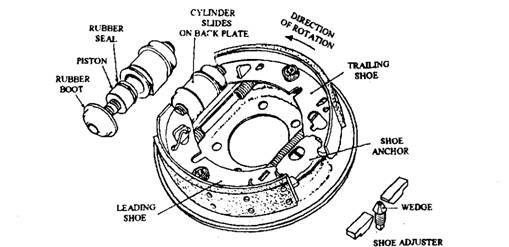

Can you post a pic! Do they look like this.
http://www.autopartsdb.net/assets/images/ProductImg/R/RE641.JPG

terry77.ta, Jan 1, 6:18pm
Hi, yes, dam near identical.great pic!
