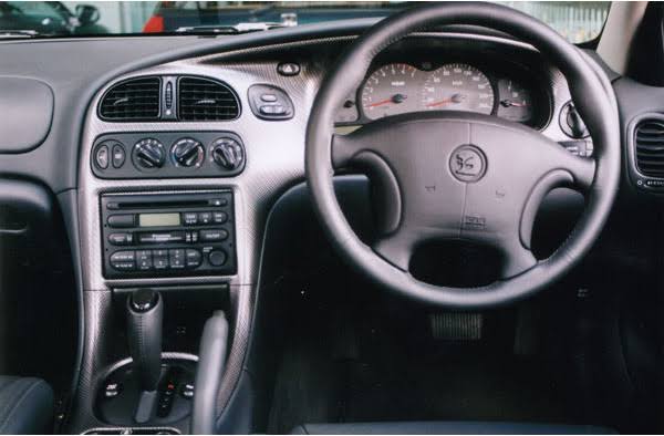

Do the blinkers still 'go slow' when the hazard lights are on?
Earth connection somewhere?
https://encrypted-tbn0.gstatic.com/images?q=tbn:ANd9GcS_dHbgL-CrAw2HjYQ7QZ41QrLEV0A1FSm8JQ&usqp=CAU
In this pic , the dashboard control unit, the one between the dash vents & the Speedo cluster, if you push both buttons at the same time for 4 seconds, it changes & somehow you can reset airbag &/or MIL lights or something from there.
